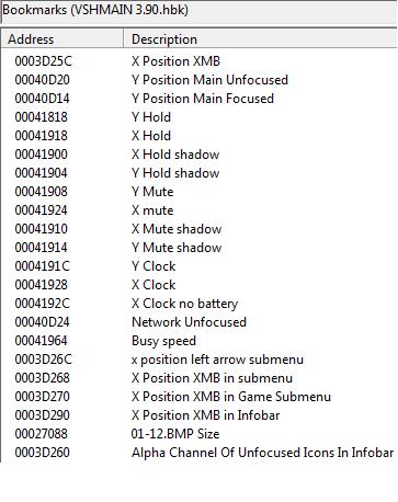

Not a PRX movement...BUT
To move the x position of games on memory stick and save data open game_plugin.rco go to page data and look at XLIST_MS_GAME -148 in the position is the initial position the memory stick will be.
X Position of games in infobar is also in here
If you go to info bar and return that value is no longer referenced,but instead it is pulled from
[GAME_PLUGIN.PRX]
14B5C -148 X Position Game Memory Stick Contents and Save Data after exiting infobar
14CF0 -148 (2nd reference but no visible change when modifying..maybe other language?)
14B48 -168 X Position Game Memory Stick Contents in infobar

40E1C -80 X position memory stick information screen
40E20 85 Y position memory stick information screen
40E28 400 Fade in time memory stick information text

SchmilK Wrote:Not a PRX movement...BUT
[GAME_PLUGIN.PRX]

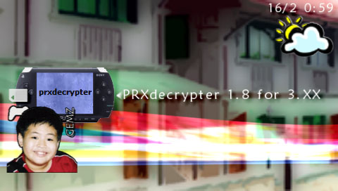

nice finds i also noticed the rco thing, so ive been looking for the same values, but i just now realized what I have been needing to do, so thank you! also its great that everyone has found so many already, i know im not much help but, i will try to find as many values in the rcos as i can.
Edit: game_plugin.rco 0x00002854 -148 x position of memory stick contents "game" (on startup of psp no "pull")
![[Image: screenshot002qu4.png]](http://img529.imageshack.us/img529/9574/screenshot002qu4.png)
(note that in this picture i edited it to be 0)

If you hex edited the game_plugin.rco and found -148 then you just did what rcoedit does when changing what i mentinoed in rcoedit. :)
