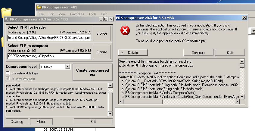

i can't get it to work!!i get an error
here:

diego_429 Wrote:i can't get it to work!!i get an error
here:
make a folder named temp in C:/
EDIT: by the way, GREAT APP :yipi:

ill try that when i get home.  . and yeah NICE app vwry usefull

i try and compress now there is no error but my psp freezes. . . what's the problem. .I decrypted the prx's myself and also dumped them myself . . . what is the problem????
EDIT: nevermind I got it to work
