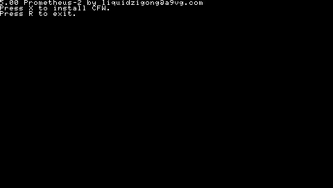

给各位坚守在5.00 M33上的朋友们,我制作了个为5.00 M33-6的增强补丁,可以为你们的CFW添加普罗米修斯CFW的功能,如直接运行原版新6.XX 游戏。同以前某人制作的"5.00 prometheus"相比,这个补丁不需要再开启任何插件,而是直接集成到系统内部。最大的保留了M33系统的优点与普罗米修斯系统的新功能。
功能:同5.03/5.50 Prometheus-2 CFW。
安装:先安装5.00 M33-6,再运行附件程序,按X键安装即可。
注意:
1. 安装后,系统版本号仍然是5.00 M33-6。但如果有用到普罗米修斯解密功能,屏幕将变红。
2. 如果游戏ISO已存在disc0:/PSP_GAME/SYSDIR/prometheus.prx,系统将禁用自带的普罗米修斯功能。这个功能是为了避免与普罗米修斯模块发生冲突而设计的。
Quote:Translation by Google:
In 5.00 M33 you adhere to the friends, I created a to 5.00 M33-6 enhanced patch, you can add to your CFW CFW Prometheus features such as direct new 6.XX original game to run. Produced by someone with previous "5.00 prometheus" compared to the patch do not need to open any plug-ins, but directly integrated into the system internal. M33 retained the greatest advantages of the system and the Prometheus system of new features.
Function: with 5.03/5.50 Prometheus-2 CFW.
Install: install 5.00 M33-6, and then run the attached program, press X button can be installed.
Note:
1. After installation, the system version is still 5.00 M33-6. However, if helpful to the Prometheus decryption function, the screen will turn red.
2. If the game ISO already exists disc0: / PSP_GAME / SYSDIR / prometheus.prx, the system will disable the onboard Prometheus function. This function is to avoid conflict with Prometheus module designed.
