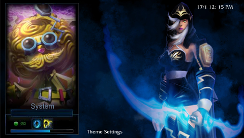

EDIT: Here's my concept of how it should look.
.rar  LoL.rar (Size: 5.59 MB / Downloads: 182)

EDIT: I managed to make the images appear up to the video category. I did that by changing the Colors to 64. However, the Game, Network, and PSN categories are still not showing. I don't know if changing the Colors to 32 is still viable since the I find the images already at low quality, but if that's the only option, then I have no choice but to reduce the Colors to 32. Do you guys have any other idea to make the categories show?
