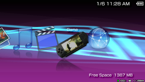

[Image: Preview.jpg]
This is a screenshot of a Wave i made called YoEddy which has a speed of 68 ( all done with TGAWaveCS........
