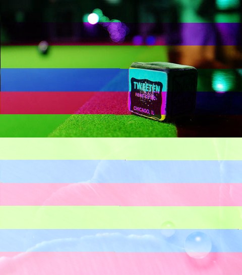

here is the original background..
05/10/2007 06:42 PM
Post: #98
RE: A peak at the PTF format
Do you know how it was made?  The Sony PTF maker?
Hmm, cause if so, maybe it screws colours up on purpose or something.
Cause, all this method does is extract the image for you - no conversion has been done... Erk
Dodgey.  It places two red and blue bars across the image...  I suspect they just swapped the colour channels.
EDIT: yep, appears to be some colour channel swapping (or possibly a skipped byte or two I guess).
Bars 1 and 4: GBR
Bars 2 and 5: BRG
Bars 3 and 6: RGB (normal)
EDIT 2: Okay, here's a sort of method to fix it - it makes artefacts appear, but that's primarily because I haven't got the exact offset here.
Open up the BMP in hex editor, go to 0xFF36 and delete one byte.  Add 0xFF00 to 0xFF36, go there and delete another byte.  Keep repeating this, by adding 0xFF00 each time.
If you get the offsets correct though, it should fix up the image.
If you do the above, you should end up with something like this:
[Image: backgroundvt7.png]
The lines should be removable if you find the exact spot to delete.

ZiNgA BuRgA Wrote:Do you know how it was made?  The Sony PTF maker?
Bars 1 and 4: GBR
Bars 2 and 5: BRG
[Image: bggn3.jpg]
quite complex... wondering how bstronga can extract the background...
