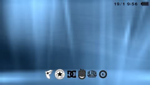

Heya , i was trying to make my self a topmenu icon for my own theme. Though when i put 6 icons on it lots of the other icons disapear. Can somebody help me please? or if i could send you the topmenu and icons?
[Image: screenshot008-1.jpg]
reduce size/ reduce color to 256
Does not look like your using large icon's,.!?
You can send me the topmenu_icon.rco if you want and i will take a look ,.!

whaot i did>>> i selected the alpha channel and copied it then i made a new picture in photoshop and set to rgb then i pasted the alpha channel,. then i selected "indexed colors" and your alpha channel had 200 colors already so less colors for the rgb,.. anyway i did index color 10,. then i copied the alpha channel back into the original picture's alpha channel,.. you should now have about 25 colors in alpha channel,.
then i "crtl" clicked the alpha channel and go into rgb/layers mode i reversed the selection and painted black arround your icon's instead of the white background,..
then i did a indexed color 60,. and then set back to rgb,.. (image>>mode>>rgb)
then i save the bmp 32bits,..
i did htis for all your icons and loaded them into the topmenu_icon.rco,.. this is for 3.71!?! yes,.. because i did not deflate the image's,.. for 3.80 you can deflate them again,.. as with 3.52,..

to deflate it use RCO editor
I was sorry for triple posting , the theme was 3.80m33  , and i didnt try the topmenu because i didnt know what firmware its for.
Edit : the topmenu i sent u was 3.80m33
and the one v1 sent back is the same topmenu, but its not been deflated, as there is no easy way to tell what firmware its for. Its still a 3.8 topmenu, it just needs deflating...or keeping the large filesize
