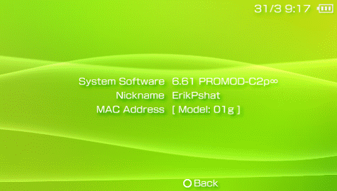

Opened 1 Seg, T-DMB, Comic Reader, x-Radar Portable, Skype, and Digital Comics in "Game" )))
PSP-1004 (Europe) FAT, 6.61 Infinity.
[Image: attachment.php?aid=5901]
